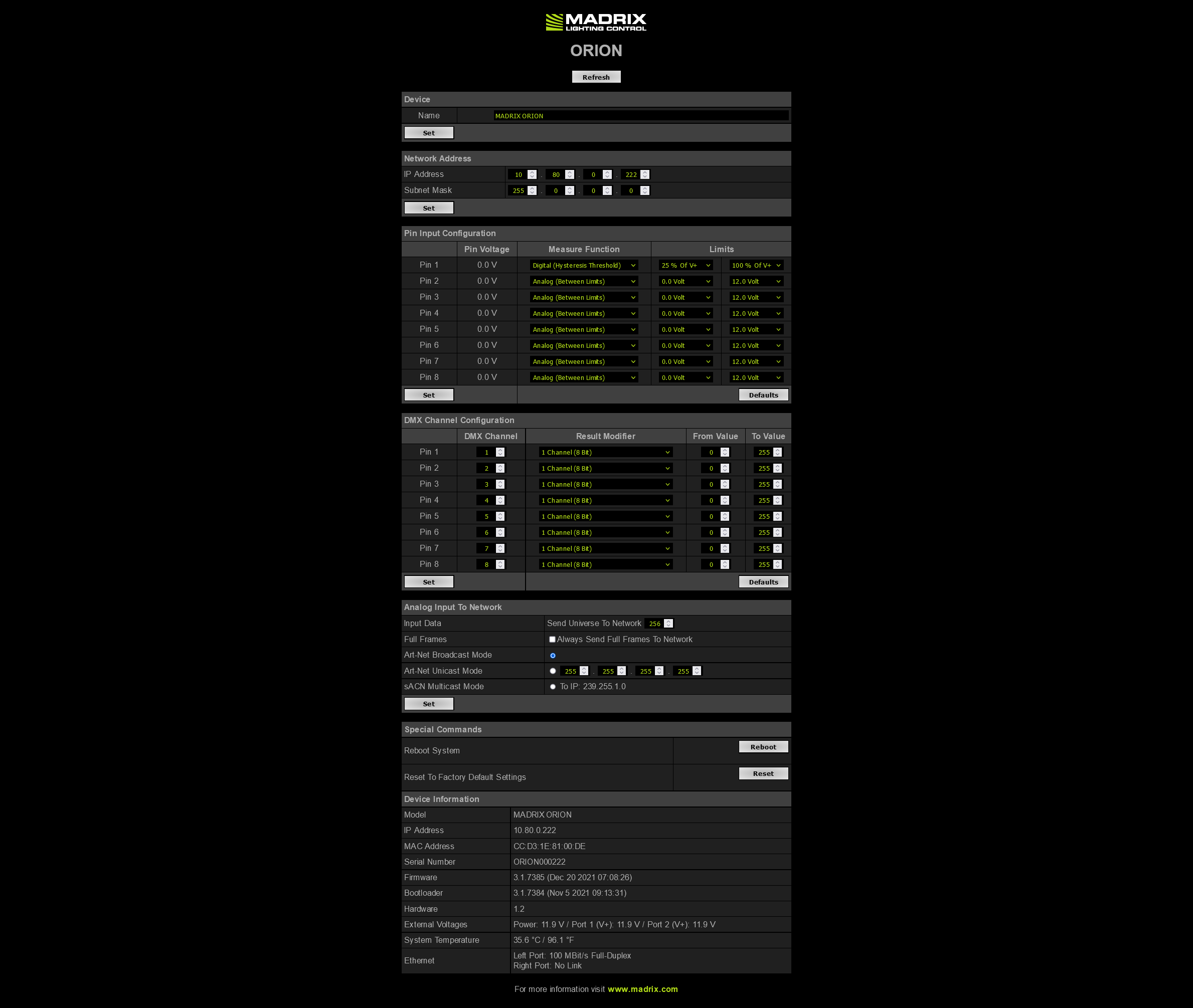

There are different possible configurations. You could use the following configuration for the ORION for example:
MADRIX ORION Configuration.png (232.91 KiB) Viewed 14468 times

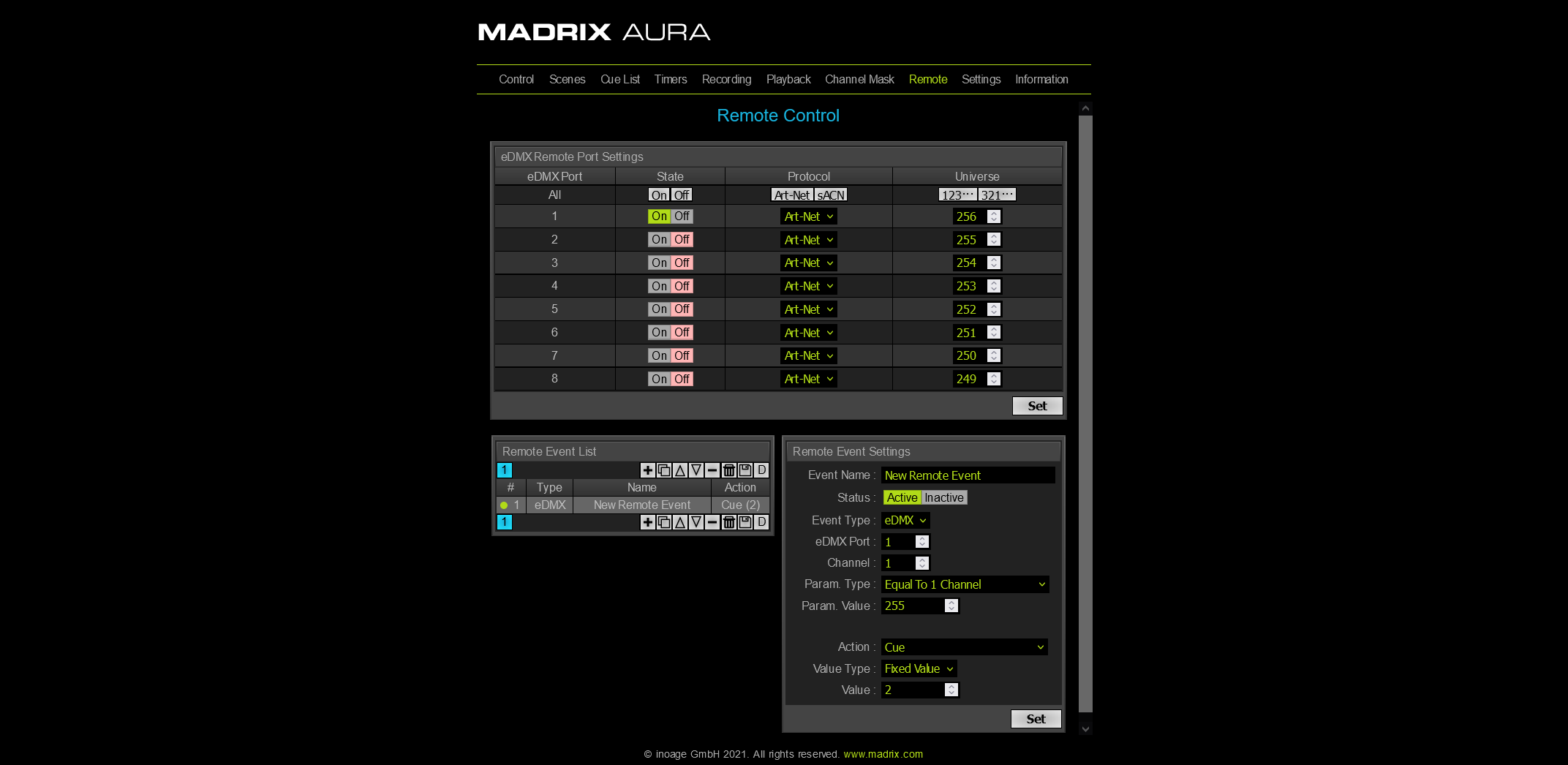

And for the AURA side:
MADRIX AURA Configuration.png (138.91 KiB) Viewed 14468 times
In my example I used "Digital" as measurement function with a minimum voltage limit of "25% Of V+" and a maximum limit of "100% of V+" and left the "DMX Channel Configuration" at default. That means if the circuit between V+ and Pin 1 is closed, the ORION will send the DMX value 255 to the AURA. On the AURA side I used the Parameter Type "Equal To 1 Channel" with the Parameter Value 255. This way the used Action will be triggered if the AURA receives a DMX value of 255 (basically this works like a wall switch).

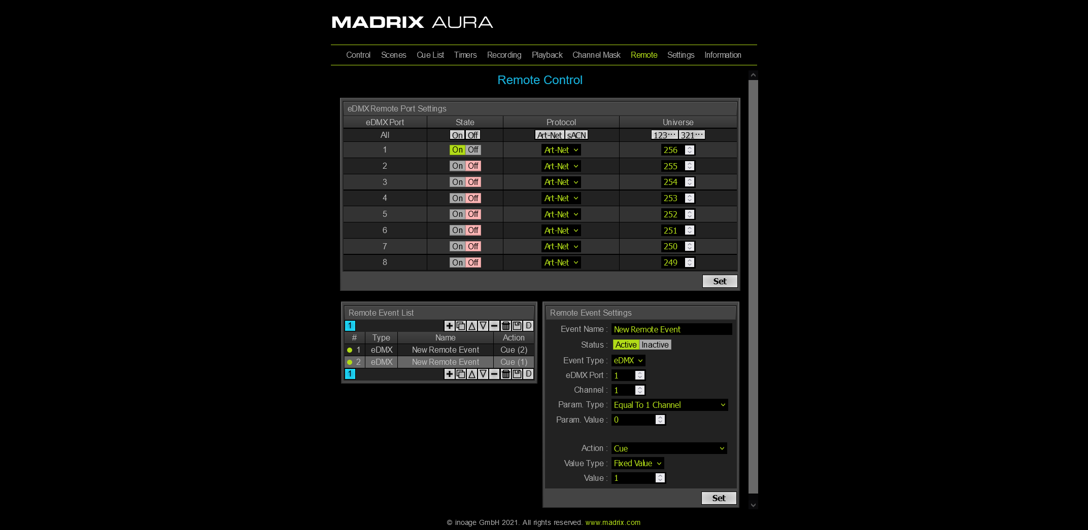

- Yes of course! My recommendation would be to set up a second Remote Event for the MADRIX AURA. This event should have the same eDMX Port and Channel, but a Paremeter Value of 0:
MADRIX AURA Remote Event Configuration.png (140.9 KiB) Viewed 14392 times

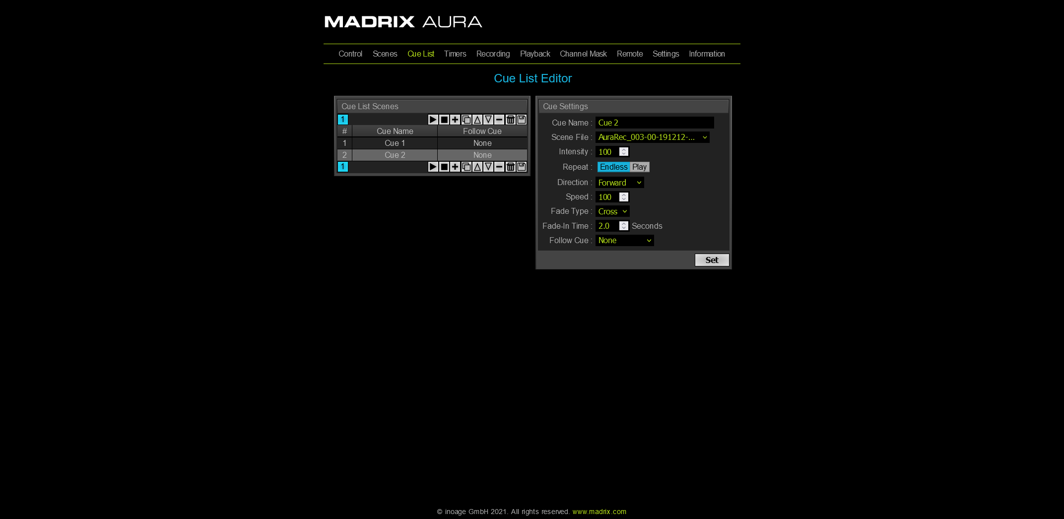

- In the Cue List I would set both Cues to be played back "Endless" without a Follow Cue (None):
MADRIX AURA Cue List Configuration.png (92.42 KiB) Viewed 14392 times
