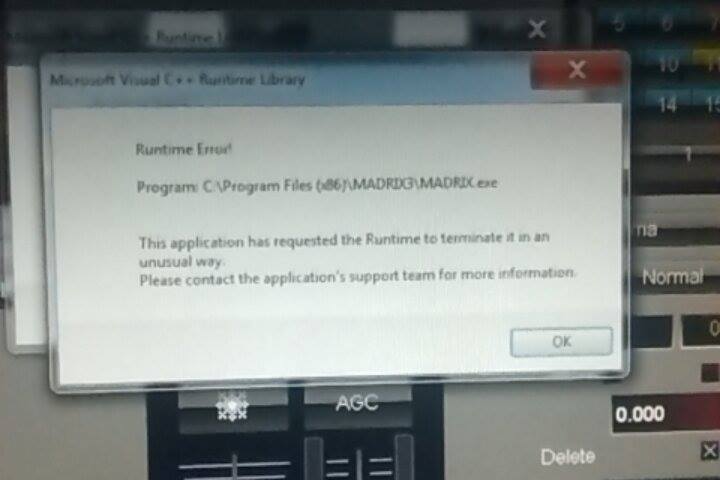

I have a client that is getting a repeated Visual C++ Runtime Error with Madrix. I don't know the specifics of the machine, but they say it's a i5 with 6GB of ram.
I've attached a screenshot of the error that they're receiving. Do you have any idea what it might be. What are the first steps I can tell them to do. I've never seen that before on any of my installations. The club is not near me, so I can't troubleshoot it myself.

Hello Nathan,
Can you please make sure that your client has installed the lates version of MADRIX 3 (at the moment it is MADRIX 3.3b).
Also please make sure that he is using the latest drivers of the periphery.
After that please send us a permanet saved logfile via e-mail to info[at]madrix[dot]com. Therefor please start MADRIX and go to "Tools > Logfile". A new window will be opened. In this window please click "Save And Log", choose a directory and save it.
Now please open the desired setup and work with MADRIX until this issue occurs. After MADRIX was crashing please send us the logfile.
Thank you.
Thank you.
