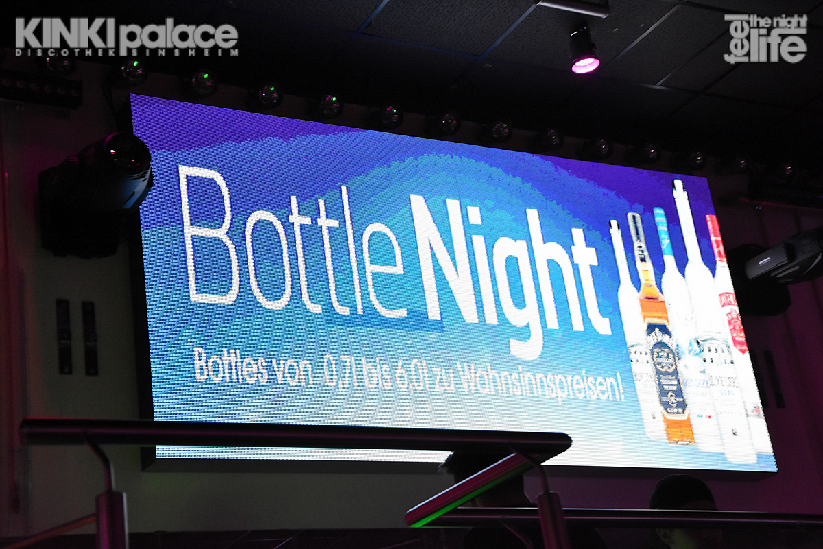

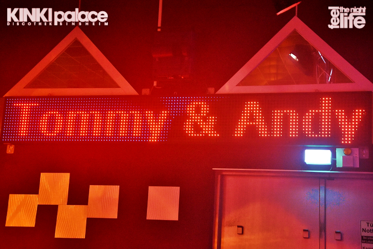

I am using Madrix since January this year. I am working in a Club in Germany/Sinsheim called Kinki Palace as a Light Jockey. We have 2 LED walls, the bigger one (2nd picture) has 640x480 resolution. The smaller one (1st picture obviously) has 128x16 resolution. We use them mostly for advertisement but I started to look more into Madrix. I just hate the step things, because of that, I started scripting. I just love it when the Light goes with the Sound. My main problem is performance and crashes in Madrix. When it comes to scripting/programming I like to have a lot of freedom to do whatever I want to get to perfection.
