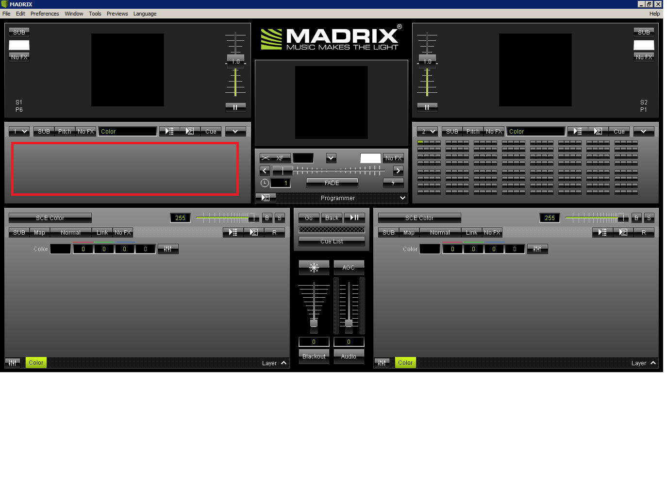

When viewing Storage Places as an 8x8 matrix and selecting a storage space and trying to drag it, all the storage spaces disappear. It gives me this problem ~7/10 times.
See attached image
See attached image
- 8x8_Drag-Storage.png (95.66 KiB) Viewed 52647 times

Hello Ismal,
Thank you for reporting this bug.
We will have a look what is going wrong and try to fix it in one of the next MADRIX releases.
Can you please send us a MADRIX logfile of this PC to info[at]madrix[dot]com?
In MADRIX, go to "Tools > Logfile", click the button "Save As..." and enter a name for the Logfile.

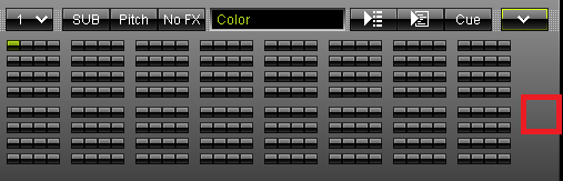

Hi, I actually found how to make this bug happen systematically.
On an 8x8 storage place matrix view, if you click and hold on a storage place, and drag it to the right it does it every time. See attached image.
It looks like a kind of out of bounds bug and can only happen with an 8x8 view.
At first I had to restart Madrix to get the view back, but I found that if you switch to another view (ex 4x4) it comes back.
I can confirm it happens with 3 of my machines, with an integrated video card, with AMD and NVidia, Win 7, Win 10, Madrix 3.6.2.0
- 8x8_Drag-Storage_position.png (6.41 KiB) Viewed 52626 times

Hello Ismal,
Thank you for reporting such a detailed instructions to reproduce it. We can also reproduce the bug and the developers will have a look what is going wrong.

This should be fixed with MADRIX 3.6c, which is now available for download.
Thank you very much!
Re: Storage Spaces disappear when dragging on 8x8 view
Great, I tested the new version and the bug is gone. Thanks
