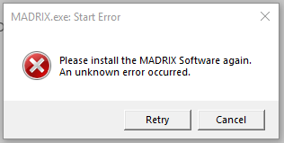

While starting I am getting error "Matrix.exe Start Error. Please install Madrix software again. An unknown error occurred." Reinstalled many times. I previously had Madrix 3 running fine on this pc. Now I tried to install Madrix 3 and getting same error.

I think I've been having the same error. When I shutdown Madrix, there is still a background Madrix task active in Task Manager.
Before I shutdown, Madrix is listed at the top of the task manager as an app, and not in background tasks. After I close Madrix, the listing in the app section goes away, but Madrix is now listed as a background task. If I end the task from Task Manager, I can restart Madrix.
I've tried uninstalling and reinstalling Madrix, but it didn't help. This has been like this on my machine for a while.

- madrix-cantstart.png (9.2 KiB) Viewed 58069 times

I also receive the same Start Error warning when I try to run Madrix via the Desktop Icon or Start Menu, while Madrix is running. The message say to reinstall Madrix, but really it is installed and running fine. It can be alarming until you realize that your Madrix window is just minimized.
I think I remember Madrix 3 giving a more informative message, such as that Madrix is currently already running, and that you can only run one instance of the program.

I installed the latest version and I have an error with this text. The program does not start
"please install the madrix software again"
