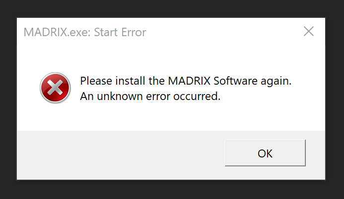

Issue:
MADRIX 5 will not start and the following error message appears:
The reason for the issue:
One of the following driver under "C:\Windows\SysNative\drivers\" is installed:
  • multikey.sys
  • vusb.sys
How to solve it?
As long as this driver is present on the system the MADRIX software can't be started.
If the software is uninstalled, which uses/includes this driver, MADRIX should start.
