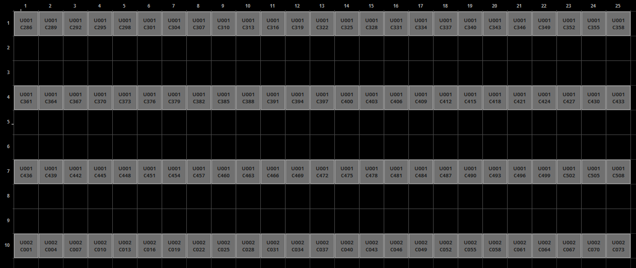

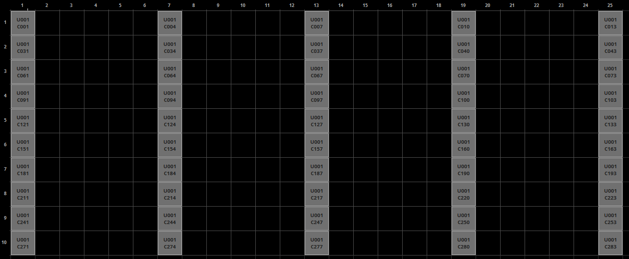

Hi Evil_Genius,
Thank you for adding the image.
I stick to my previous post, therefore I recommend to patch all the horizontal lines on the first z-layer and the vertical lines on the second z-layer. I added two screenshots of how the patch might look like.
