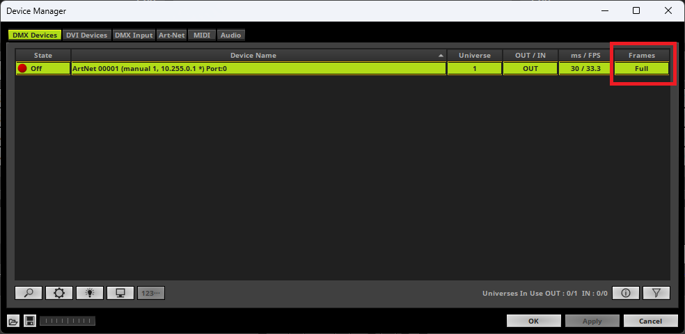

Could it be that the connected fixtures do not allow to receive a non-complete DMX universe, that means less than 512 channels?
What happens if you activate "Full Frames" in the MADRIX 5 Device Manager? Therefore please navigate to "Preferences" > "Device Manager..." > "DMX Devices", select all devices from the list and change the "Frame" setting to "Full" instead of "Optimized" (see screenshot).
Explanation:
- By default MADRIX 5 is only sending the patched amount of channels to the interface, e.g. if you only use 4 channels, it only sends those 4 channels. This is called "Optimized" output / Optimized Frames.
- On the other hand it is also possible to always send 512 channels, this is called "Full Frames".
Explanation:
