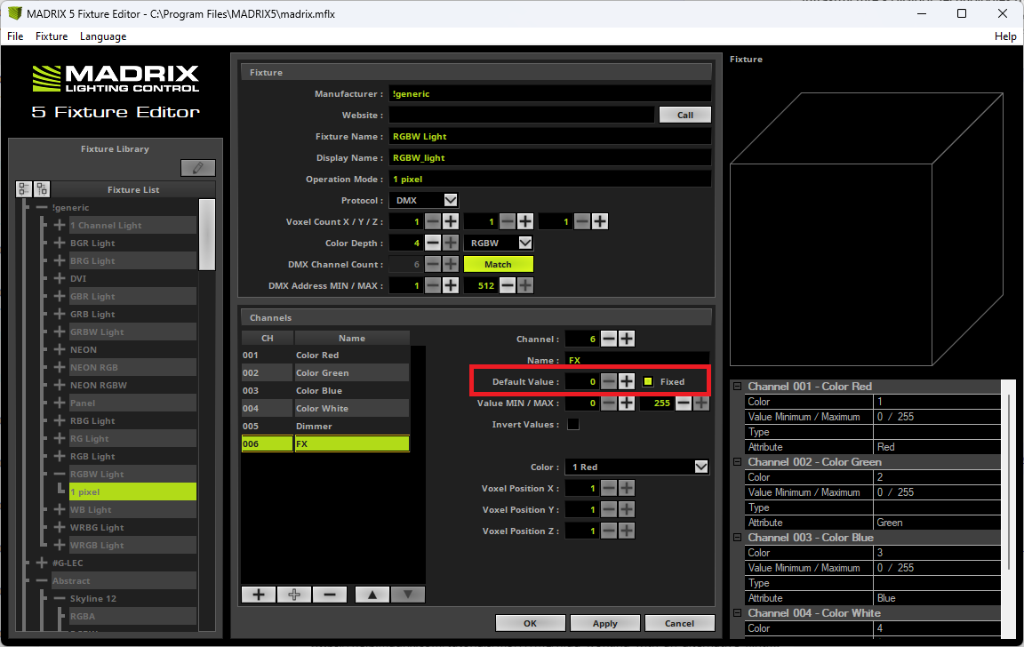

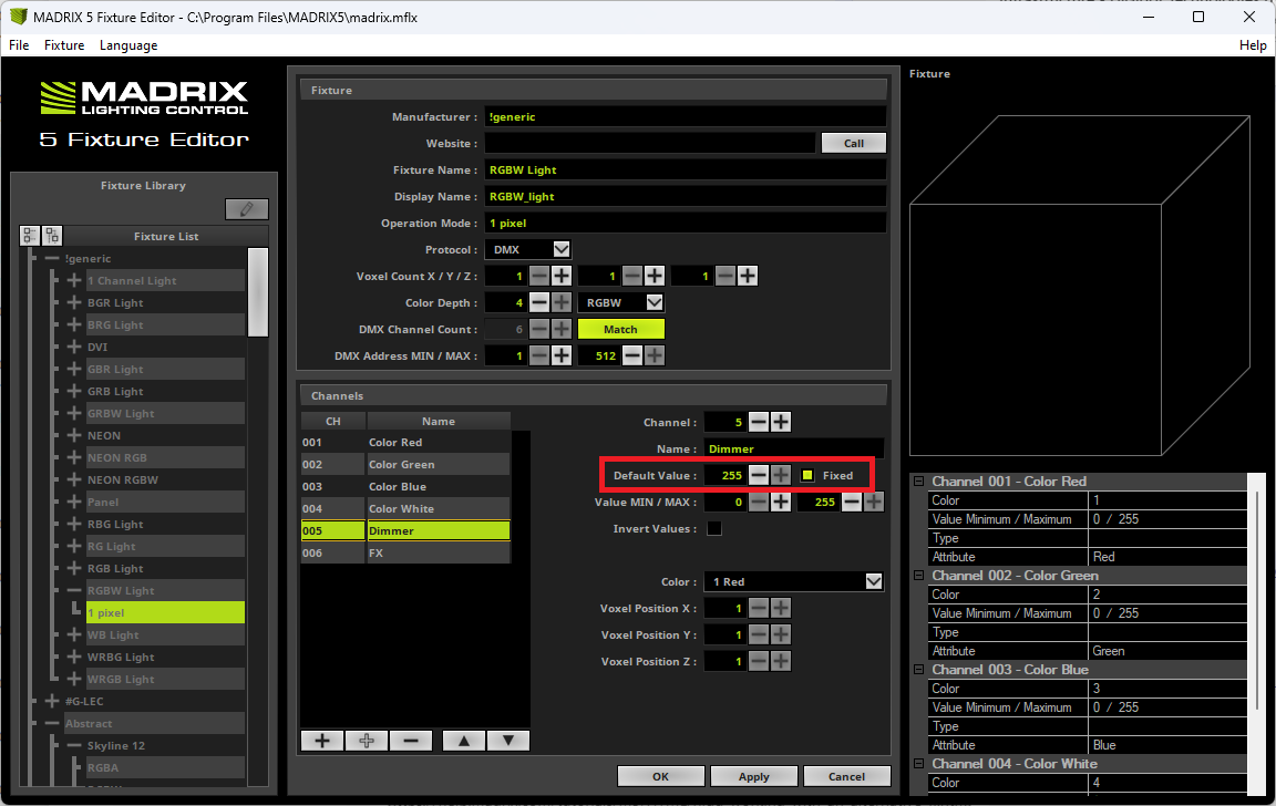

You will need to create a corresponding fixture profile with the Fixture Editor. The dimmer channel needs to be set "Fixed" with a "Default Value" of 255 and the FX should be also "Fixed" with a value of 0.
You can build the fixture file yourself or you can send us the DMX chart to info[at]madrix[dot]com.

- Fixture Editor_2.png (89.59 KiB) Viewed 2576 times
- Fixture Editor_1.png (89.61 KiB) Viewed 2576 times
