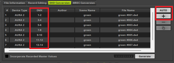

Hi PLebegue,
You don't have to record the scenes twice. Just record your scene in the *.mrec format and then use the "AUTO" or "+" button in the "DXD Conversion" tab of "Record Editing" menu. This will create multiple *.dxd files, one for each AURA device. So lets say you your matrice consists of 14 universes and each AURA has to output 2 universes. MADRIX 5 will create *.dxd files with 2 universes each, one with universe 1,2, the second one with universe 3,4 and so on. After the conversion you will need to upload the scenes for universe 1 and 2 to the master AURA, the scenes for universe 3,4 to the first slave, the scenes for universe 5, 6 to the second slave,...
Here you will find further information (part - DXD Conversion):
https://help.madrix.com/m5/html/madrix/index.html?hidd_record_dialog.html
- DXD_Conversion.png (26.51 KiB) Viewed 117 times
