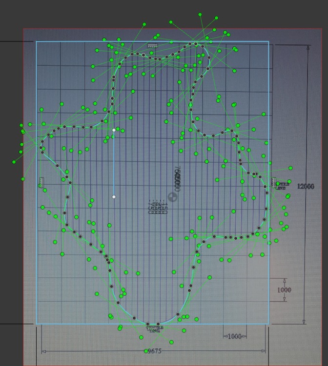

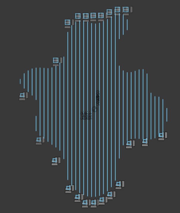

I have a project to do in Madrix 5. We are going to purchased the Madrix Ultimate. I was hoping to understand which would be the best method to do the mapping and design of this fixture.
There are 38 rows of 60 LED's / m in various lengths. I would make fixtures for each row then add them sequentially or I was hoping to make a fixture of the whole area so that all the pixel alignments are perfect.
Is there a way to import a DXF file into the Fixture editor of the layout with the pixels and each of its Address input points ?
From what I understand from my past experience, it is only possible to make multiple fixtures. Just wanted to check before I do that incase there is an easier route.
Attached is what it all looks like
Thank you
Thank you

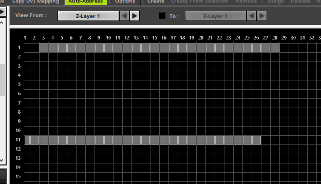

Ok , I have taken your advice and tried to run the map as single pixels. I will sort out the Universes later, I just wanted to check that if I put and x/y Co-ordinate into the spreadsheet, it will put the pixel in the correct spot. This is where I was have an understanding problem that my Fixtures were not going into the correct spot.
So I made just 2 lines of LED lights with consecutive x numbers and 2 different y values, hence 2 lines
I put one line on pixel line 20 starting at pixel 20 to pixel 45 and another one on pixel line 30 starting at pixel 18 and ending at pixel 43.
the result after the import was disappointing and the same problem I had before. Not putting them in the correct places.
Image of the result attached.
If I can find out why it puts it into the incorrect position , that would be helpful. Is there a formula which I can follow, surely it cannot be random
Thank you
Thank you

Re: Advanced fixture creation
Hello djpeterlewis,
By default, the software automatically crops/removes any empty spaces the data sets might produce regarding the start position. This means that the start position of the first fixture is set to 1 / 1 / 1 in order to reduce the Matrix Size. If you need to set your fixtures to a certain area, use this setting to enter the appropriate offset.
By using the Start Position X / Y / Z you can add the desired offset for X and Y.
'The full documentation about the CSV Fixture List import you can find under the following link:
https://help.madrix.com/m5/html/madrix/ ... mport.html
As it is default to crop it, how can I turn off that default ?
Hello djpeterlewis,
You can't disable the cropping of the CSV import.
But you can adjust the Start Position X/Y/Z to the desired start value.
The reason for cropping: If there is space at the front top left, you will waste PC performance and also the calculated MADRIX effects are out of the middle point. Because the empty space at the front top left will be part of the matrix size.
