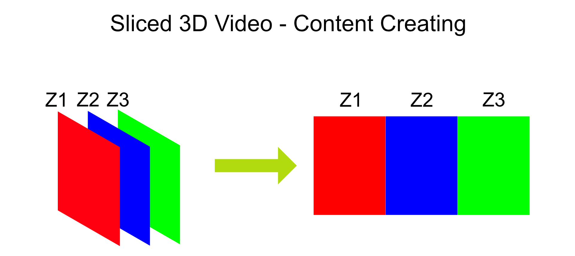

Re: What formats of 3D moving objects best for 3D presentations?
Hello ChrisCotton,
In the attached image you can see an example how a 3D video/moving image content needs to be prepared and loaded in MADRIX. In this example every Z-Layer was added side by side and thus a large 2D image/video was created. It is important that a slice has the correct size. That means the X and Y resolution needs to be exactly the one of the used patch in MADRIX.
Once you load this video you have to click the "SL" button in the "SCE Video" effect and setup how many slices and how they are created.
After the settings are applied MADRIX will move the content of the 2D "sliced" video into the next layers. The turning point of the layer will be pixel exact after the size of the patch.
- slicedVideo.png (52.1 KiB) Viewed 466 times
