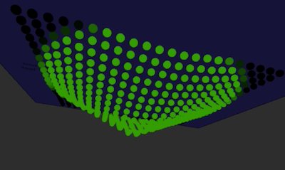

I created an application in Processing to allow me to visualize how Madrix is controlling the Orbis Fly fixtures:
Screenshot 2016-10-21 12.35.12.PNG (100.52 KiB) Viewed 72615 times
My grid of lights is 22x22 and I created a patch that is 70x22. Within that I have a grid group that controls colour that is 22x22, then two pixels space, then a grid group that controls motor position at 22x22 then two pixels space, then final grid group that controls motor speed at 22x22.
The new group function in Madrix is really helpful for this install. It quickly let's me map layers to certain area, and even apply master level controls to a group so I can easily limit the length that motors go out.
