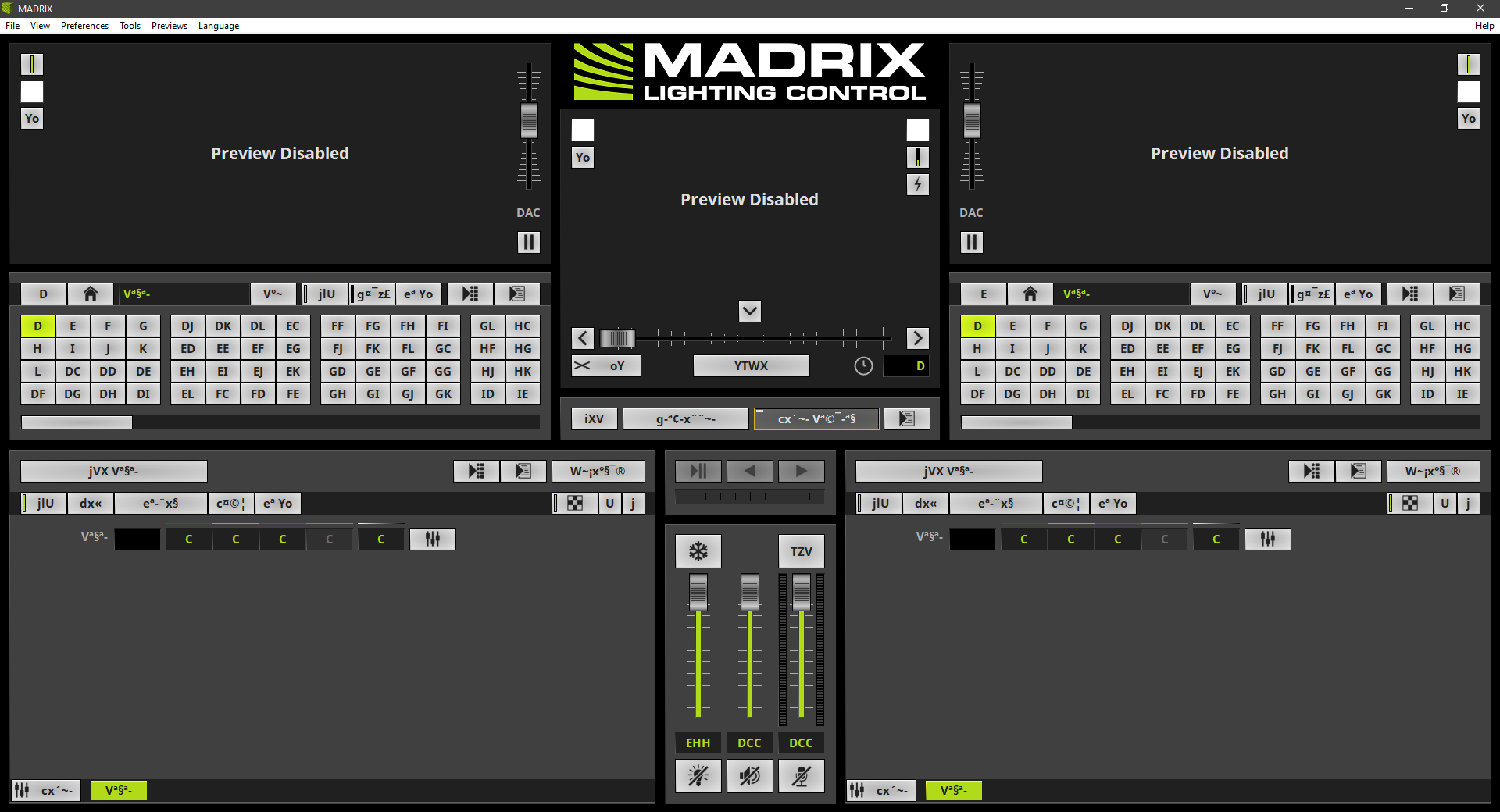

Issue:
MADRIX 5 appears with corrupted fonts as visible in the attachments.
The reason for the issue:
- The issue is caused by a faulty "Google Noto Sans Bold" font (version
1.04).
How to solve it?
- The solution is to uninstall the "Google Noto Sans Bold" font from your computer or to download the updated font from our website.
1.04).
How to solve it?
