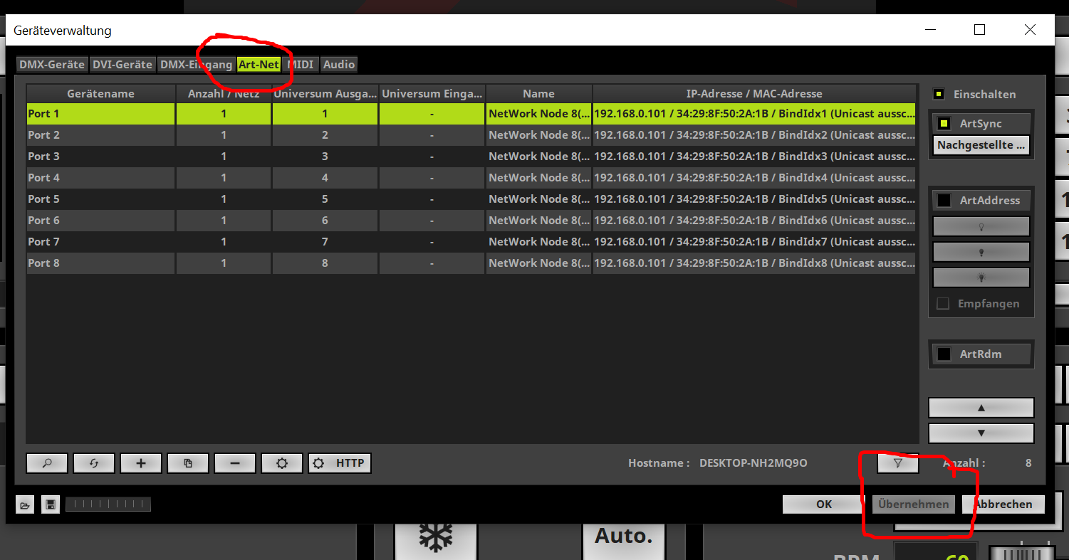

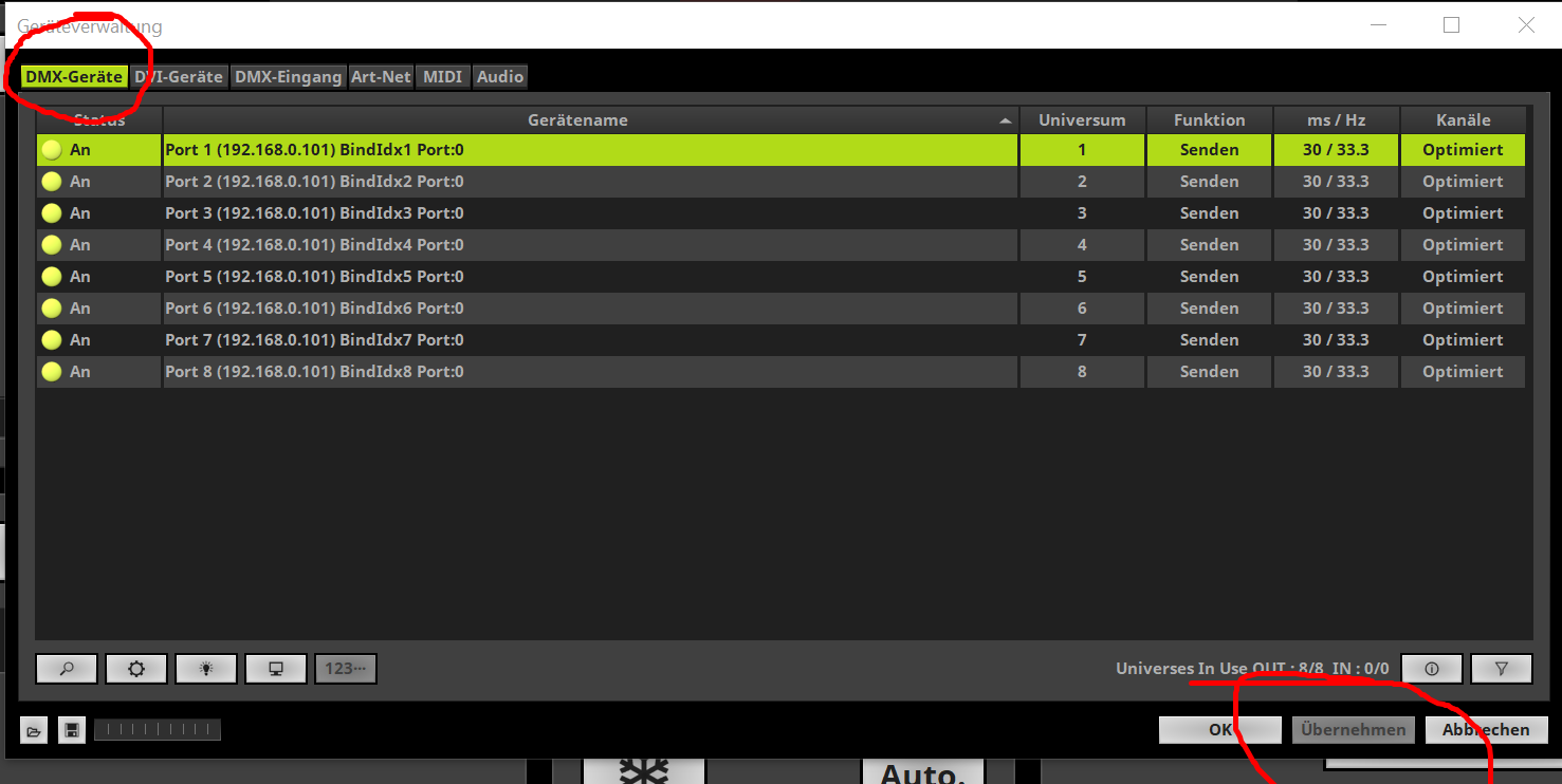

Hello, I'm the new one
I'm currently testing 4 pixel mapping software so I can buy one
I have a problem with madrix right from the start
I don't get any Artnet output, network and IP are correct - the artnet node is also found but I can't click on APPLY, see pictures
please help - thank you
- Screenshot_2.png (120.6 KiB) Viewed 4389 times
- Screenshot_1.png (77.81 KiB) Viewed 4389 times

According to the posted images there is no need to click Apply. MADRIX is now sending Art-Net data to the fixtures. But to send data MADRIX 5 needs a valid license (MADRIX KEY) connected. Otherwise it is running in Demo Mode and no effect data can be sent. Only the Highlight of a Port/Universe can be sent by clicking the "Highlight" button (Bulb).
If a MADRIX KEY with a valid license is connected and there is still no output, please send us a MADRIX logfile via e-mail to info[at]madrix[dot]com.
To create a logfile please navigate in MADRIX to "Tools > Logfile", click the button "Save As..." and enter a name for the Logfile.
Thank you.
