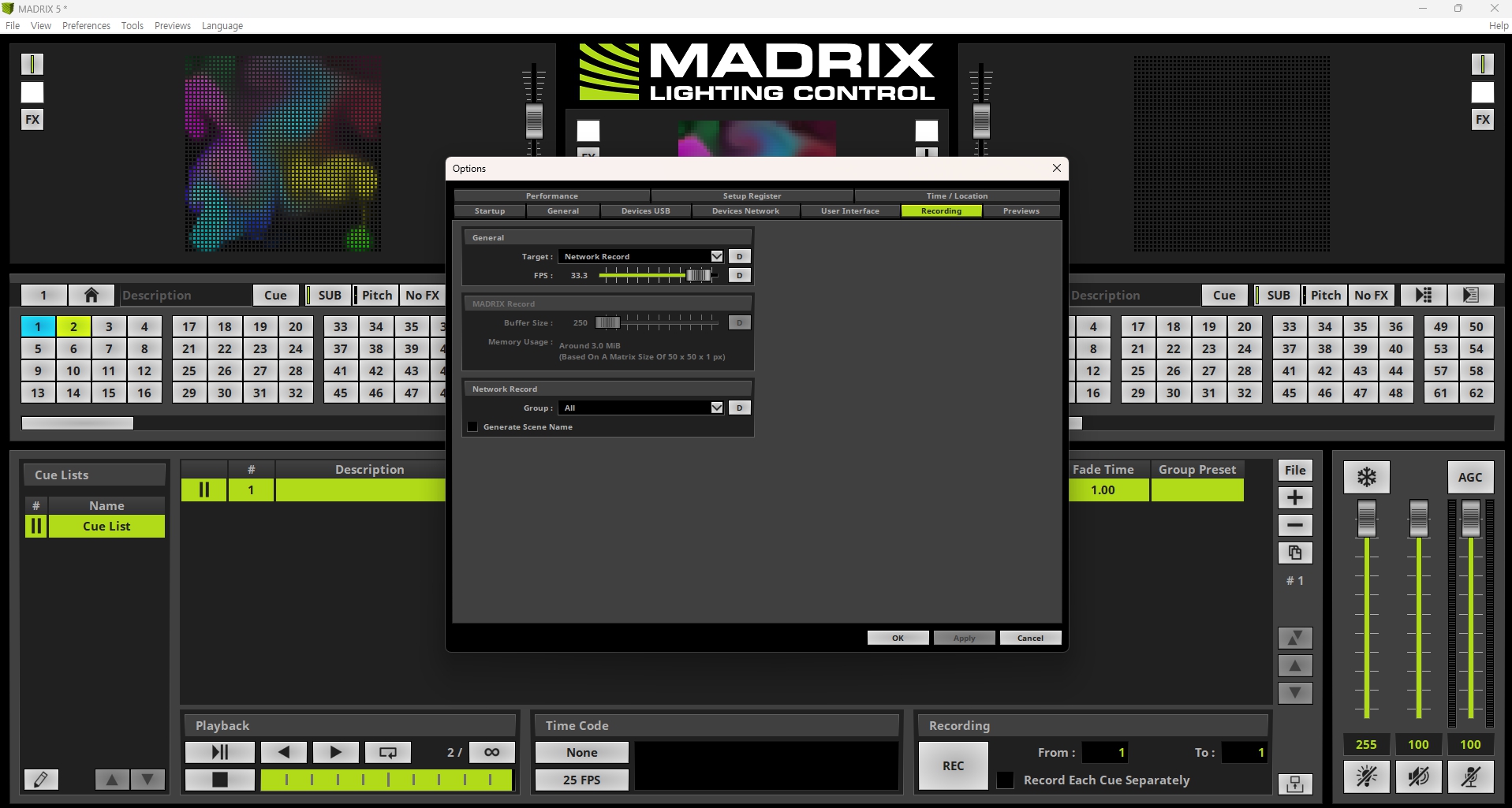

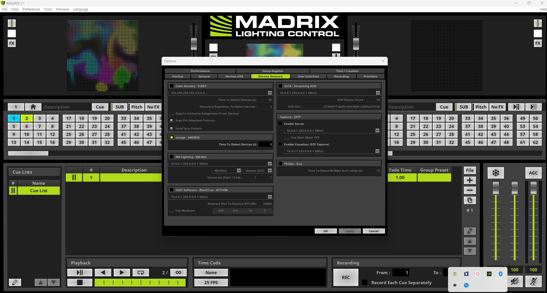

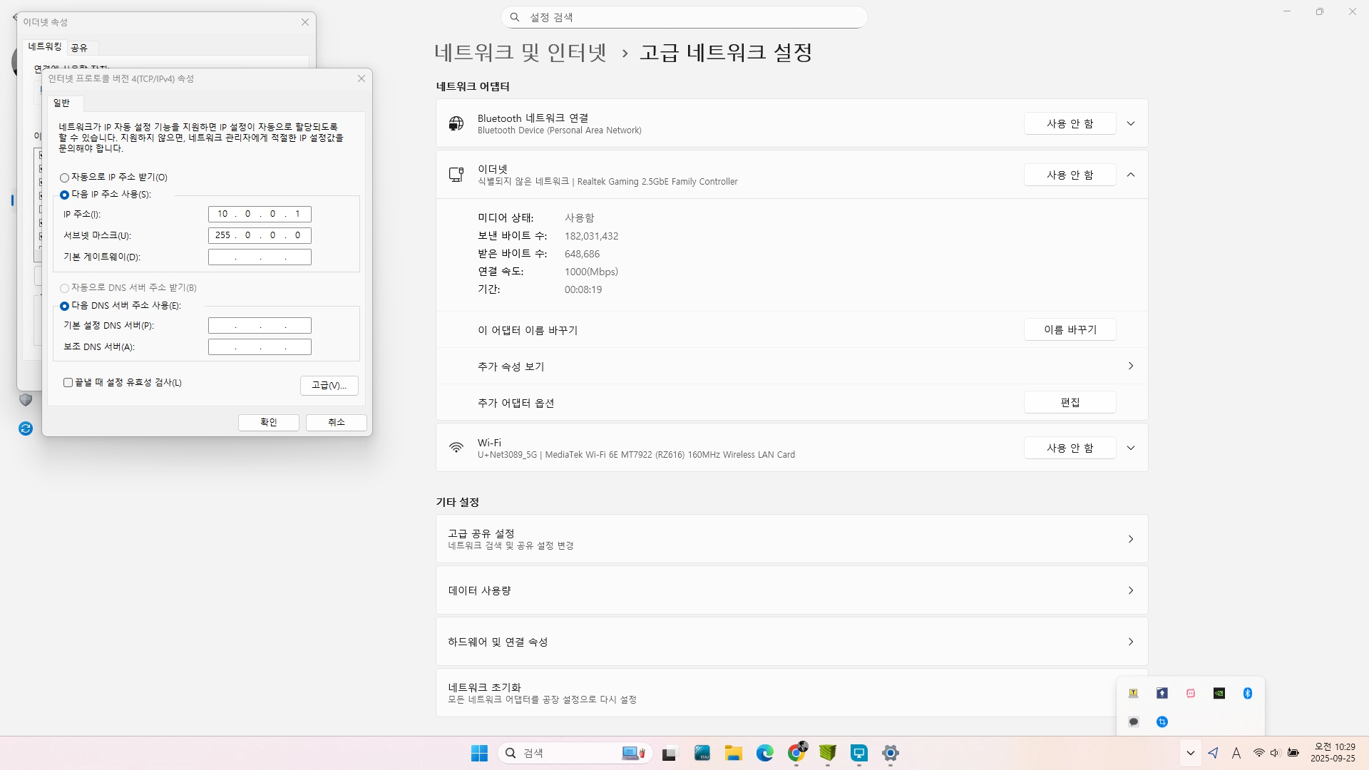

Thank you for your reply.
I have already configured a static IP address on my computer (10.0.0.1 / 255.0.0.0) and set the AURA device accordingly. I also activated the "inoage – MADRIX" checkbox in the Preferences > Options dialog as you advised.
However, the recording is still not working.
For your reference, I am attaching the screenshots of my current settings.
Could you please check the attached configuration and advise me if there is anything I might have missed?

Hi Dohyun Kim,
Thank you for the screenshots.
Please send us your MADRIX 5 setup and a logfile to info[at]madrix[dot]com. To save the logfile please start MADRIX and select "Tools" > "Logfile...", click the button "Save As..." and enter a name for the logfile.

Re: MADRIX Aura 12 Not Recording Over Network or USB
I believe I’ve found the cause of the recording issue. It appears that Wi-Fi was enabled, which interfered with the process. After turning off Wi-Fi, everything worked properly.
Thank you very much for your help and guidance.
