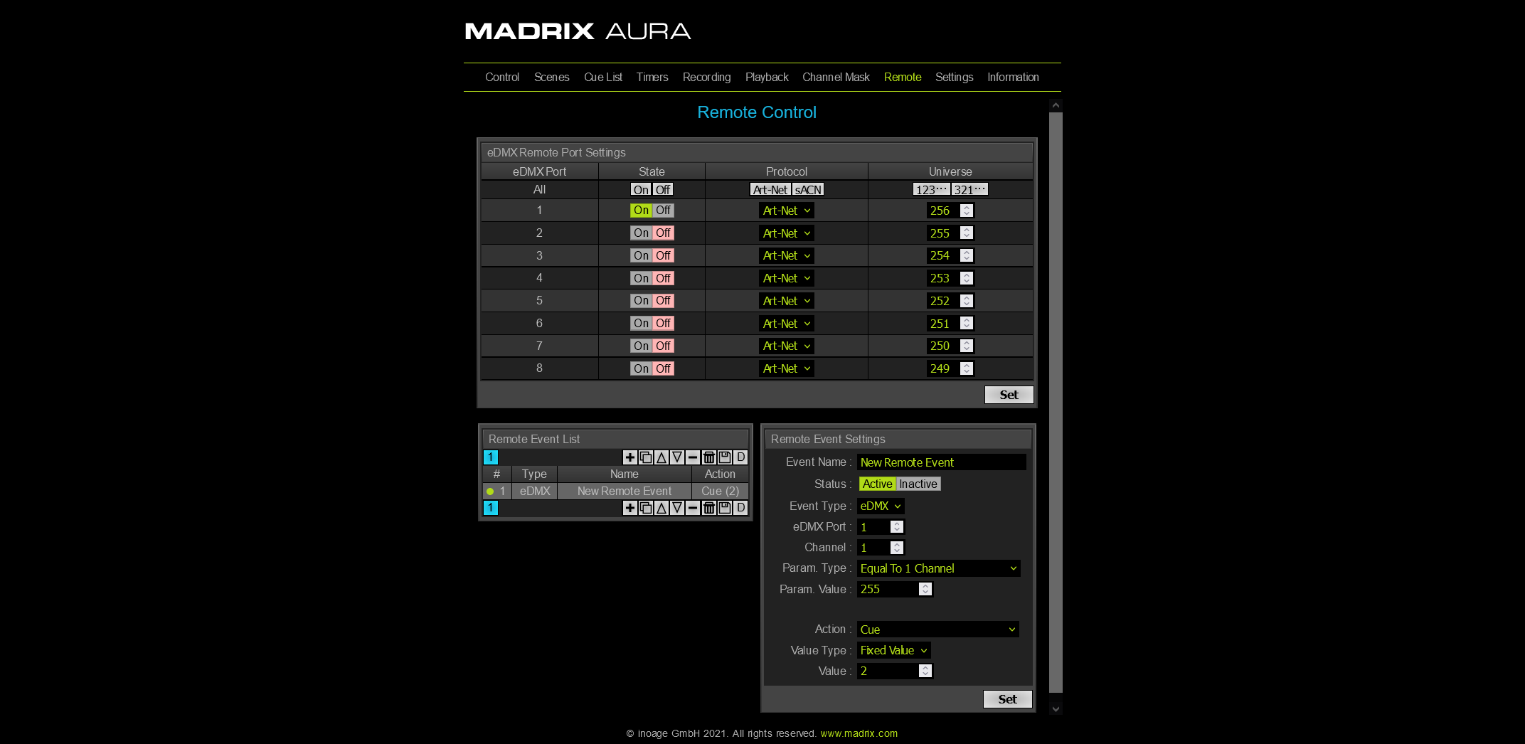

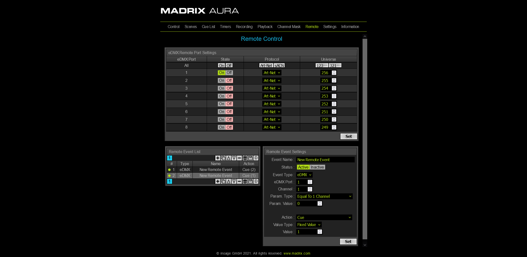

"Now is there a way to get it to hold on cue 2 until button is released?"
- Yes of course! My recommendation would be to set up a second Remote Event for the MADRIX AURA. This event should have the same eDMX Port and Channel, but a Paremeter Value of 0:
MADRIX AURA Remote Event Configuration.png (140.9 KiB) Viewed 13722 times

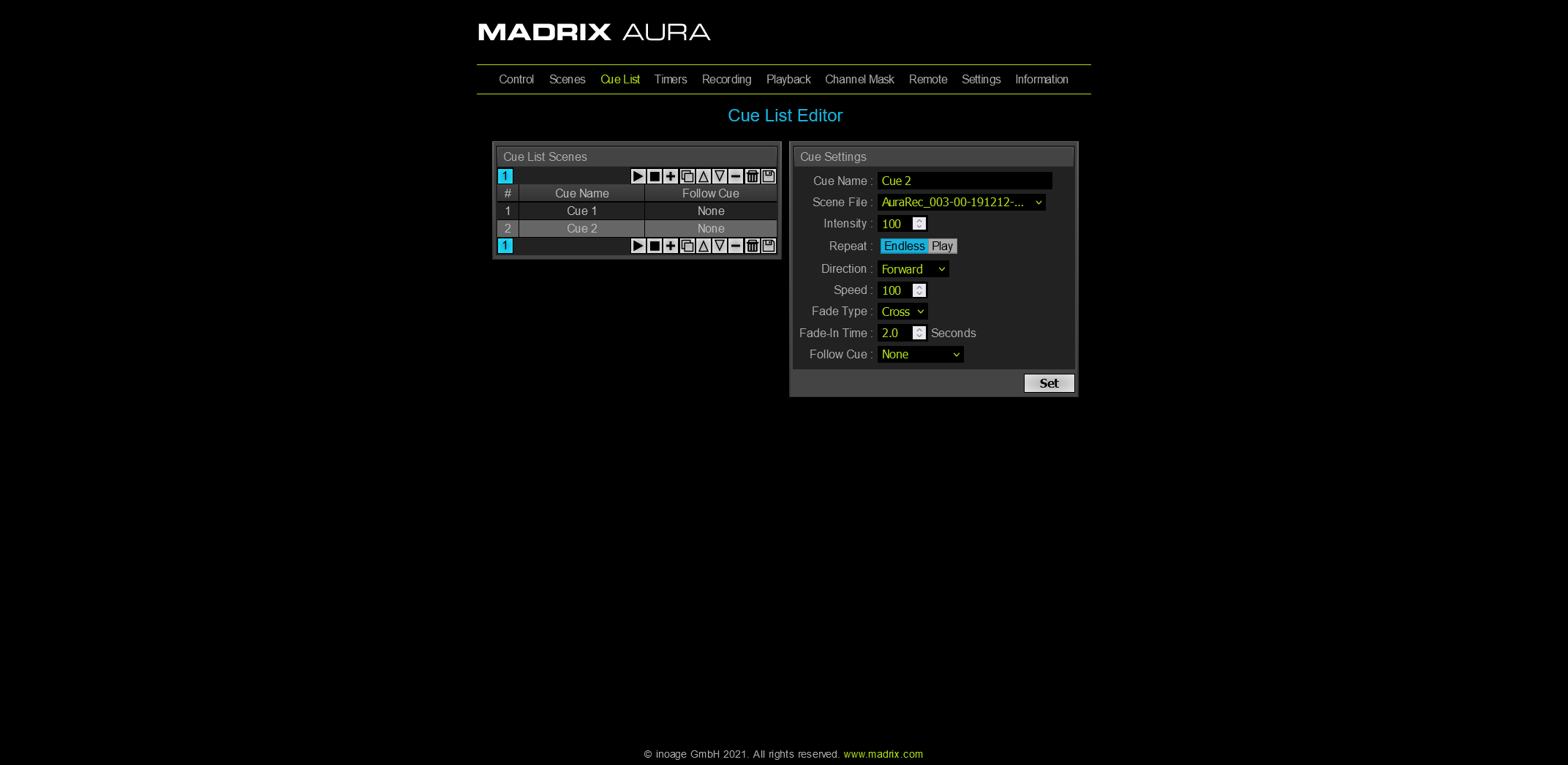

- In the Cue List I would set both Cues to be played back "Endless" without a Follow Cue (None):
MADRIX AURA Cue List Configuration.png (92.42 KiB) Viewed 13722 times
